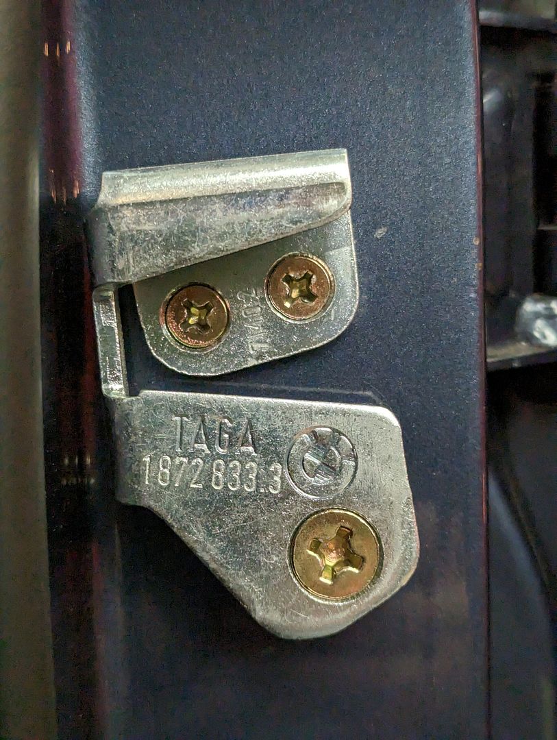

Door Latch Adjustments:
I replaced all the Door Strikes (the ones on the body) during the Interior project with new ones. I was originally going to just replate them (which I ended up doing anyway) but it was actually cheaper just to buy new ones. I replaced them but could never get the final adjustments done in order to completely cinch the doors closed. It is a frustrating process of back and forth, micro adjustments; the solution is kind of counterintuitive that in end, by my own humble & embarrassing admittance, was accomplished by someone else (thank you wkohler; he schooled me and did it in under 5 minutes

Hood Latches:
This was to correct a mistake/misstep I did back in 2016 wherein I re-plated them in yellow zinc. They are supposed to be a form of Green Cad, a finish that is very hard for modern platers to match (at least the ones I know around here). At the time (early 2022) all four components were still available from BMW, so that’s what I did.
-First I had to remove the previous yellow zinc versions which means I had to drill out the four pop-rivets holding the base receptors onto the front nose. Be sure to put down copious amounts of towels or cardboard to catch all the metal filings and the spent rivets (they go everywhere). In fact magnets would help a lot.
-Installation: Feed the release cable through the driver’s side and then across the top of the radiator shroud/nose over the passenger’s side. It doesn’t really matter which side you start to install first, just be sure you need to feed the release cable through the driver’s side receiver catch first.
-Be sure you pick up or borrow a good quality HD rivet gun since the BMW rivets are steel not aluminum. Steel is needed since these are under a fair amount of force and tension. If you’re using a hand-powered version get ready for a workout. You might also have to grind off or file off any messy cut tabs (in theory you shouldn’t have to with a quality tool as it should snap off the legs cleanly; mine didn’t). You want to be careful if you do grind/file them off so as not to scuff the rivet heads too much as they are very visible (if that matters to you).
-Make the final release cable connections into the receiver latches and install with the proper yellow zinc M6 set bolt. Test the cabin release lever then tighten the bolts down. (There should be a visible indentation on the cable from where the connection was before, so start there.)
-Next install the upper catches on the hood itself. Again, there should be marks on the hood where the old catches were so start here. The holes are cut with a slight oval for adjustments particularly the driver’s side with the release handle. You should also note the amount of threads on the bolt under the springs are showing on the old ones since this is you starting point for the hood seating. Adjustments are straight-forward: loosen the locking nut at the base, use large regular screwdriver to rotate the bolt and spring up/down or in/out. If you’re doing this from scratch, it will take some back and forth (opening/closing of the hood) to find the right position for these. Same for the horizontal positions of the latches on the hood. Slightly tedious but should be okay if you’re starting at the old positions. I believe this process is spelled out in the Bentley's. You can get the official BMW bolts with integrated washers or you can pick up correct yellow zinc hardware somewhere for the four bolts holding both sides to the hood.
-That’s it. Clean up, make one final check for latching and safety catching and hood seating. Be sure to apply any additional grease in the receivers catches (they come with some from the factory but you may need more). There are two plastic cover caps that slide onto the bottom of the receivers on the nose; be sure to install these before the headlights as it's easier access. Close it all up and you’re done.
[I know, one of these days I may have the whole radiator support/nose repainted. It's original and wasn't repainted with the rest of the car back in 1990/91. It's looking a bit tattered.]
