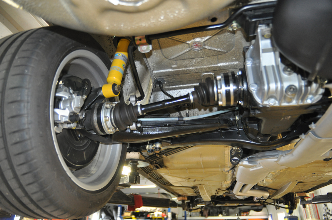

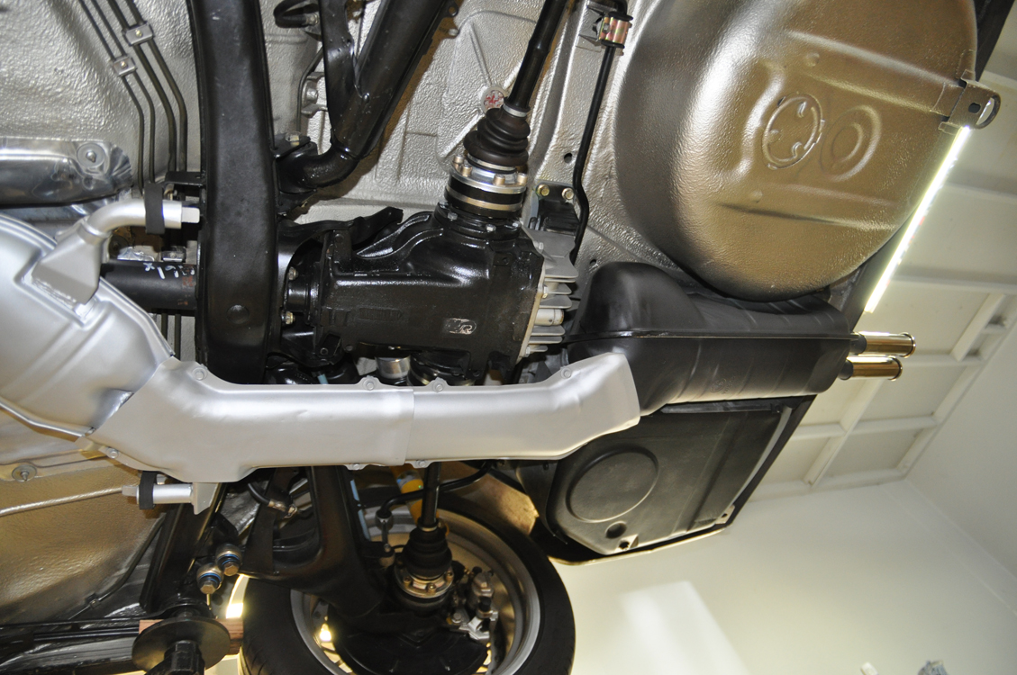

The rear subframe is out. It would have been better/easier to pull the diff and axles off first. The whole contraption is just way too heavy to man-handle with only two people under a 4 post lift. I could see it being easier to do if the car was just on jack-stands and a rolling dolly underneath, but with the 4 post lift we had to rotate it 90 degrees while supported on a transmission jack and then use our backs to actually lift it to the table. We got it done, and there were no deaths, but I have suspicion my back may go out in the next few weeks...
Nothing will happen this weekend (we have a wedding to go to) but next week I'll pull the diff and clean it up and maybe paint it. I have another nice diff cover (no reason this one won't clean up nice with the soda blaster). The diff oil was changed just a few K ago, so I'm loathe to pull the cover off, but I can't stand it having red paint on it. I'll pull the TAs off this sub-frame and clean/paint them too. I may paint them aluminum. I have new bushings for the new subframe, but I may just use these as they only have about 8k miles on them. Not sure how hard powerflex bushings are to remove. If they are hard to remove I'll just leave them in...this subframe is going in the blue car eventually (with adjustable camber kit). All the other bushings should be fine as they were all done at the same time. I'll also clean the hell out of the underside of the body.

Re: Vlad: The Zinno '87 535is
if you're gonna throw out your back, you'd better make it worth your time. are those shocks fresh?
that underside isn't quite worthy of the fresh paint. maybe Ken should continue painting. ;)
cek wrote:The rear subframe is out. It would have been better/easier to pull the diff and axles off first. The whole contraption is just way too heavy to man-handle with only two people...
You'll have time to heal before reinstalling the thing. Just remember what you learned and reinstall the subframe before the diff & axles.

I am saving up for the blue car now, so im not going to go nutz here. No big sways, bearings are fine, and no moar powder.

#Vald is a nice car. Given the fact that it is a daily driver, I really don't see the point of refinishing every piece under the car. It makes more sense for a garage queen or a car that will be shown.
