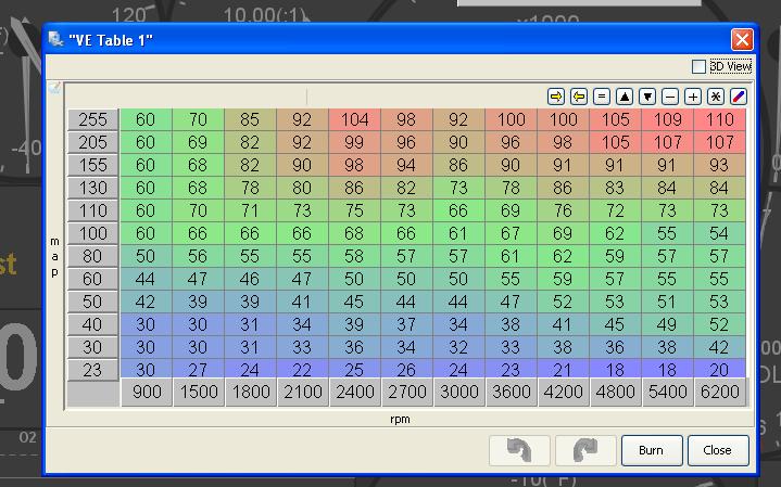

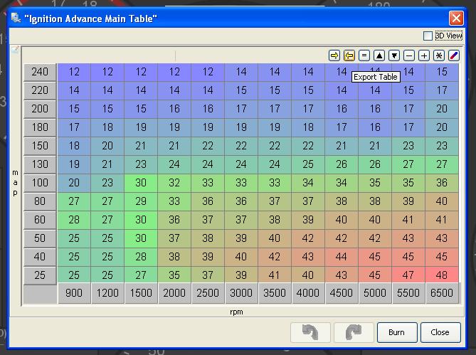

Post up your VE and Spark maps.

I could probably work on both maps a little more. I'm curious to try some race gas and see how much power I can extract from timing alone.

grsmonkey wrote:I could probably work on both maps a little more. I'm curious to try some race gas and see how much power I can extract from timing alone.
This map seems inconsistent. You seem to pull a lot of timing out between 100 and 130 kpa. If 33 degrees is good at 100 kpa, 28 should be good at 130. You should be able to dial in a little more across the map at 150 kpa too. It shouldn't be sensitive to detonation until you're in the 160-180 range and up. The bins around 180-200 above 4000 rpm could use some work as well. If you can use 16-17 at 200 kpa, you should be able to run a few degrees more than that at 180. You should never have flat spots in your table, nor should you have sudden, steep drop offs.
If you're not up against detonation with your current tune at your current boost level dont expect to make any more power with race gas. Its all about minimum best timing. If you're already there on pump gas you've got nothing to gain from running more expensive fuel.

Dan, thanks for having a look at the maps. To be honest, I haven't even thought of the bins directly above 100kpa since I dyno'd at 10psi. The dyno op had me pull a bunch of timing after I made one pull. I knew I could add more timing in even at 10psi, but I guess since it was "dyno tuned" I left well enough alone.
I'll have to change the 180kpa bins, if I try to run too much timing there, it starts to pull ~20% of those numbers at 1bar (14.2-14.9psi). I'll bump 200 down to 190 and 180 down to 170 and see if that helps. I know I can't run more than 15-16 degrees just below 5k at 1bar.
