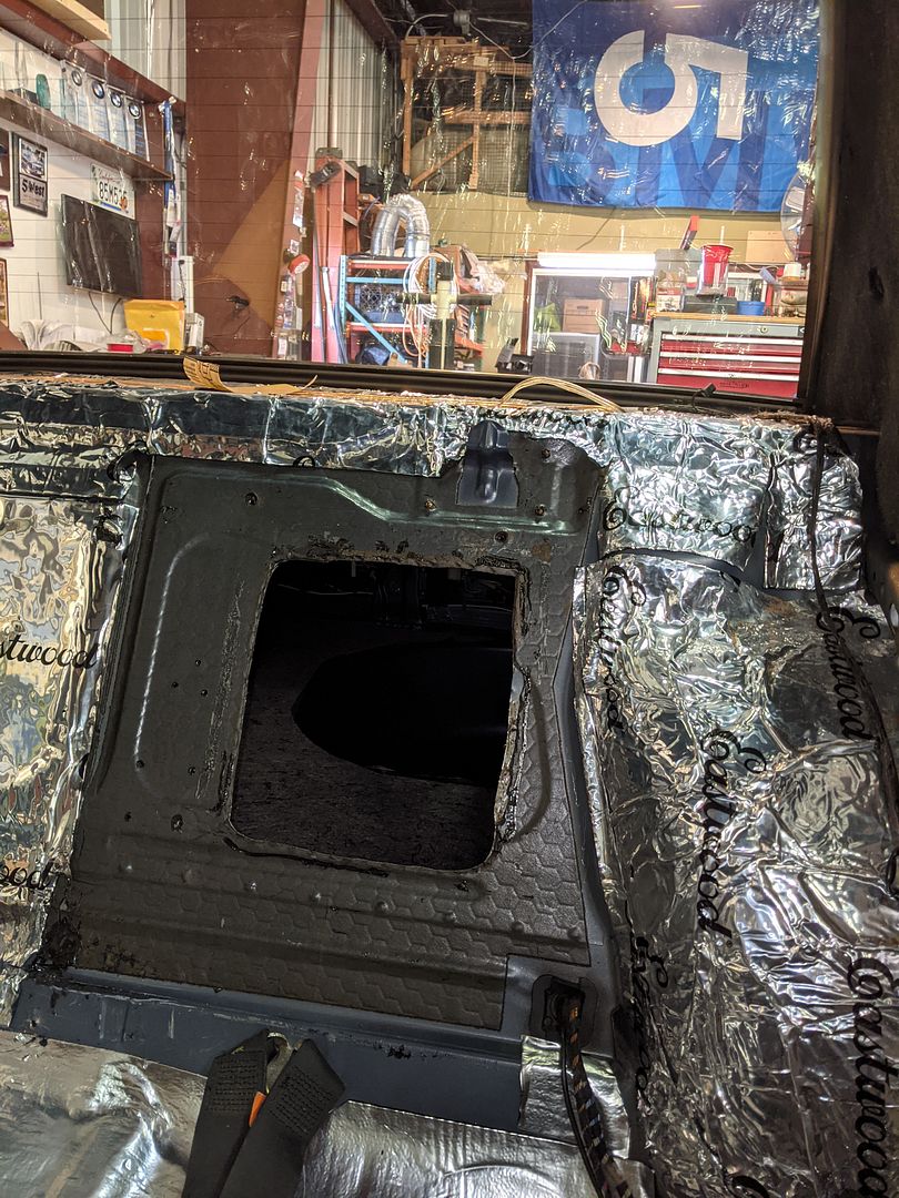

-Install a panel over the hole in the Rear Bulkhead (someone’s hack subwoofer install) from another E28 graft

Level 1: Liquid Acoustic Membrane (HeatShield db Skin). As you saw earlier, I used this on the roof and Rear C-Panels. I only installed one +/-10mil layer here since I was layering more on top of it and I didn’t want to wait another 24 hours for the second coat to dry (okay, this was the driving factor since time is of the essence right now).
Level 2A: Miles and miles of Kilmat 80mil Butyl Sound deadening materials. Up the front floor/firewall (to the dash line) and down across the whole floor. I already installed a similar product in the Rear Seat Well and Bulkhead a few years back. I also stitched in a few pieces of new mass-loaded high density foam matting where I cut into it the OEM brown stuff during demo. This was done with new HeatShield db Sniper material.

A layer of Heatshield db Stealth Thermal backing (same stuff I have on the roof under the headliner).
In between this and during this same time I was installing all my final audio wiring: RCA and speaker signal wires from the head unit to the trunk (up one side and the middle), speaker wires from the rear seat well to the front speakers:
One new thing I’m trying is a remote power cut-off switch for the entire trunk, the primary object there being the audio amp board (I have a few other items running off the big battery lead cable as well). I have suspected since I put this amp board in that it has been vampiring my battery in a big way. Even after putting in a brand-new AGM battery, it would pull down a full charge pretty quick sitting there in the hangar. This was fairly proven out to me because since I have had the amp board and large cable disconnected, my battery has been perfectly happy. After a bit of Big A research, I came up with this cutoff switch with a remote trigger switch that I will put discreetly in the glove box. Admittedly it was a lot larger than I thought it was going to be, but it fits nicely under the rear seat:
I ran a new 4ga copper wire from the battery to the rear seat well and then into the trunk. I haven’t connected it yet nor tested it, but I did get the amp board and rest of the trunk power network put back in this past weekend so it’s ready for testing.

INTERIOR TRIM:
This is broad category since it involves buttoning up the remaining parts and components on the front dash, center console and misc. Some highlights:

Trunk & Audio System: The Audio System in this car deserves an entire thread unto itself (and will likely follow this one; actually it is as much an ongoing saga as this whole M535i thread), but since I had to spend a considerable amount of time dealing with the system (removal, re-wiring, adjustments, re-installation) I need to mention it here as it was part of the original scope of work. A brief history of this system:
2017: I have had a vintage a/d/s/ component system with varying different Head Units since 2011 but in 2017 I cooked up an upgrade to this system that may have been inspired/willingly forced by El Guappo (Jay3), the car audio-guru himself. Up until this point I had a single a/d/s/ PH15 6-channel amp with an a/d/s/ 642Csi Processor, front & rear component speakers (a/d/s/ 344is front lows, Orion p.2Concept front highs, and a/d/s/ 325is rears) and one sub-woofer in a box in the trunk. I had a newer Kenwood Excelon X895 Head Unit that gave me AUX, USB, CD and BT telephone. The upgrade stemmed from wanting to replace both he HU and 325is rear speakers and quickly morphed into a re-design of my amp board with a significant boost in power to the system. This started with new a/d/s/ 300is rear plate speakers and a vintage Blaupunkt SQR88 Woodstock HU. The Woodstock is from about 1988 and is cassette deck with AUX input on the front panel with 4 channel output and most importantly is period correct for the car. My goal was to make an Audio System that, while not being original to the age of the car, would have been one that the owner would have graduated up to in the few years after they purchased the car. All the EQ in this system is dated from the late ‘80’s to very early ‘90’s and were all top of the line in their day (heck, it all still beats most of the modern tech even today).
2019: This new system took a while to figure out and gather the right components and wasn’t fully cooked until a few years later. The new system consisted of: (2) a/d/s/ Ph15 amps, (1) a/d/s/ 642iX Processor, (1) a/d/s/ A206 DIN Assignment Module, (1) 8” Coustic BassPump subwoofer, the same front speakers and the Woodstock HU. The concept is that the entire car is split down the middle acoustically with each of the PH15 amps handling the right and left sides (fronts, rear and one of the subwoofers in the BassPump). Each PH15 is conservatively rated at 300watts but in reality can handle much more, the Processor with DIN splitter assure the signals are properly routed and phased and can be adjusted independently (from both the Amps and Processor).
2021: This system proved to be very complicated and very finicky to adjust and get right; truth was I was chasing problems in this system from day one in 2017. This project was hoping to clear most of the remaining issues up since I had to remove the whole thing, wiring and all, to do the interiors. There were also some issues with the Amps overheating on long road trips and thermal cycling; I am still designing and R&D’ing a ventilation fan system to try to remedy this. In fact, I installed the relay and control wiring for it during this project as most of it is under the rear seat (see the photos below). Since a few of the main issues with the system may be stemming from the vintage Woodstock HU I opted to test drive an alternate new HU, a Continental TR7411U, which is ostensibly just a radio with AUX & USB inputs. I prefer the Woodstock as sonically speaking is far superior to the Continental, but it’s getting the job done for now. Thoroughly testing both HU’s is an ongoing exercise.
The other item in the trunk was refinishing my spare BBS RS211 wheel and getting new spare tire. Mike at Tru-Wheel in North Hollywood is one of the best and tracked down the correct paint to match my other four wheels. He now has the paint so my other four are going in for refinishing early next year.
