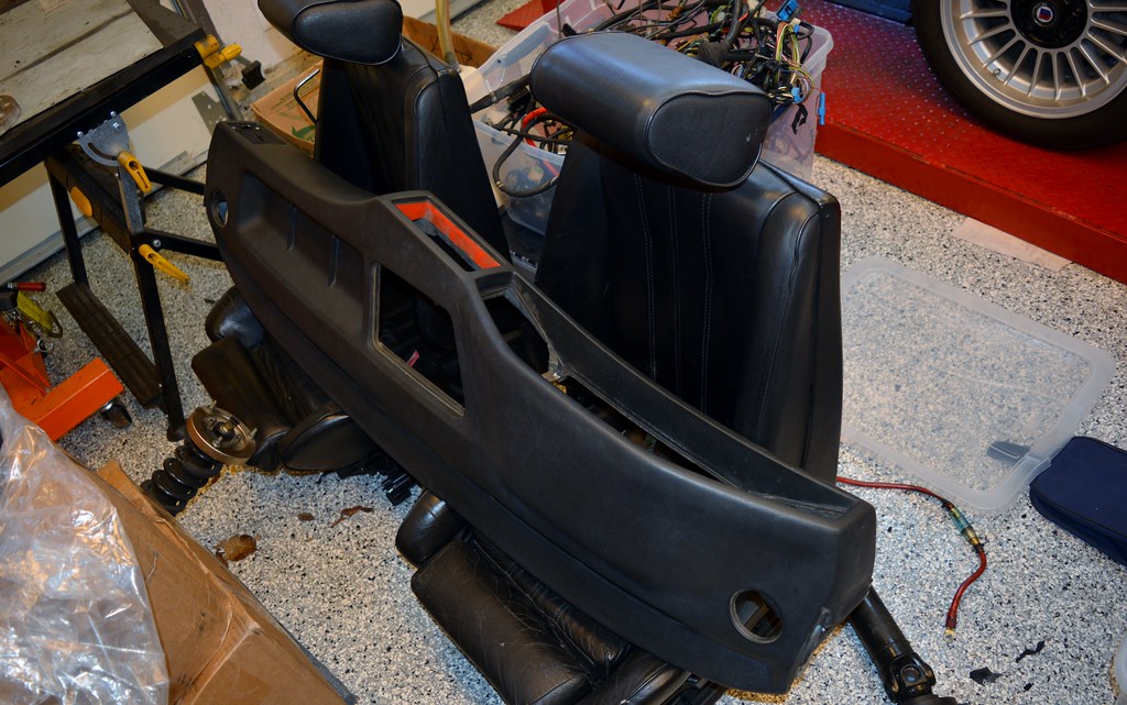

Got a crack-free dash. I'm still undecided on whether to go naked or covered. If I cover, then this one will go in Vlad since it has some tiny cracks that will cover well. If I go naked, then...

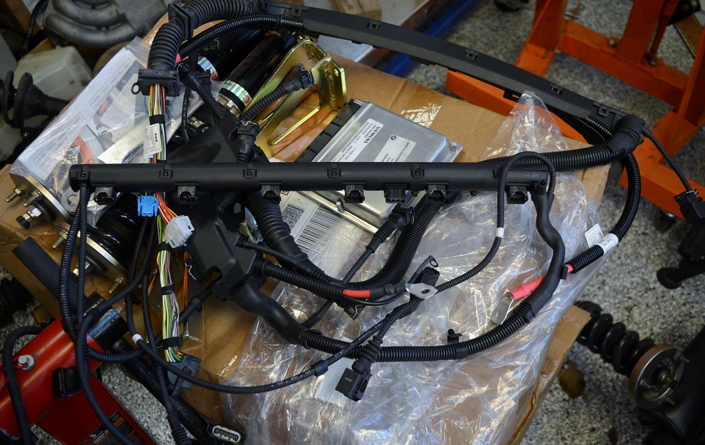

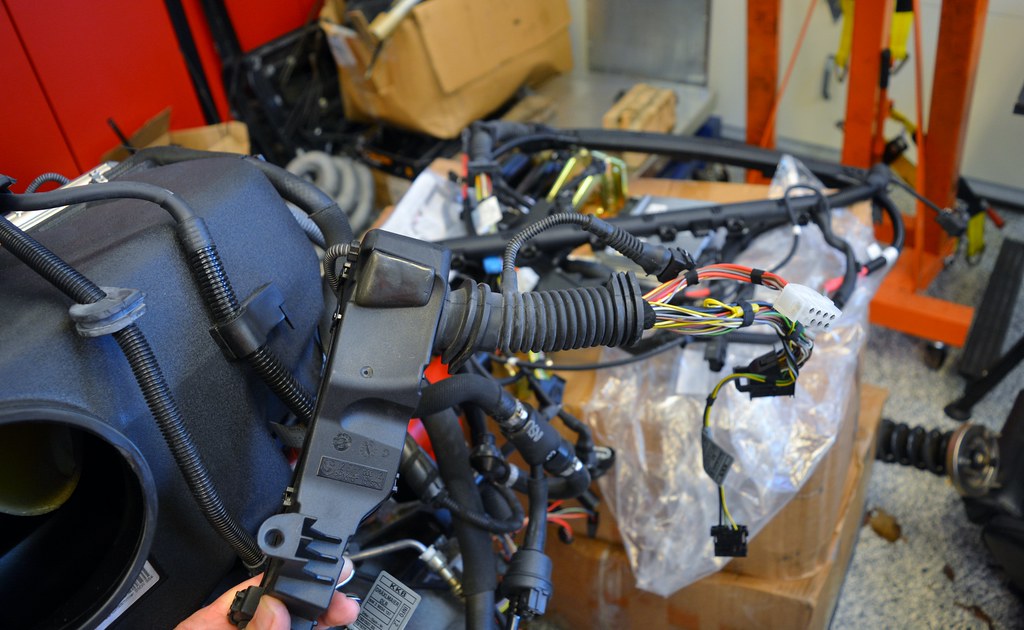

I have been working on my wiring harness. I've decided to use my checkbook wrench and pay a guy on R3V for the harness adapter. The E46 S54 harness is too short to reach into the glovebox. The Z3 M harness is longer, so I sourced a new one of those via Ivo. I goofed around with both today measuring and trying to figure out how I'll mount stuff.

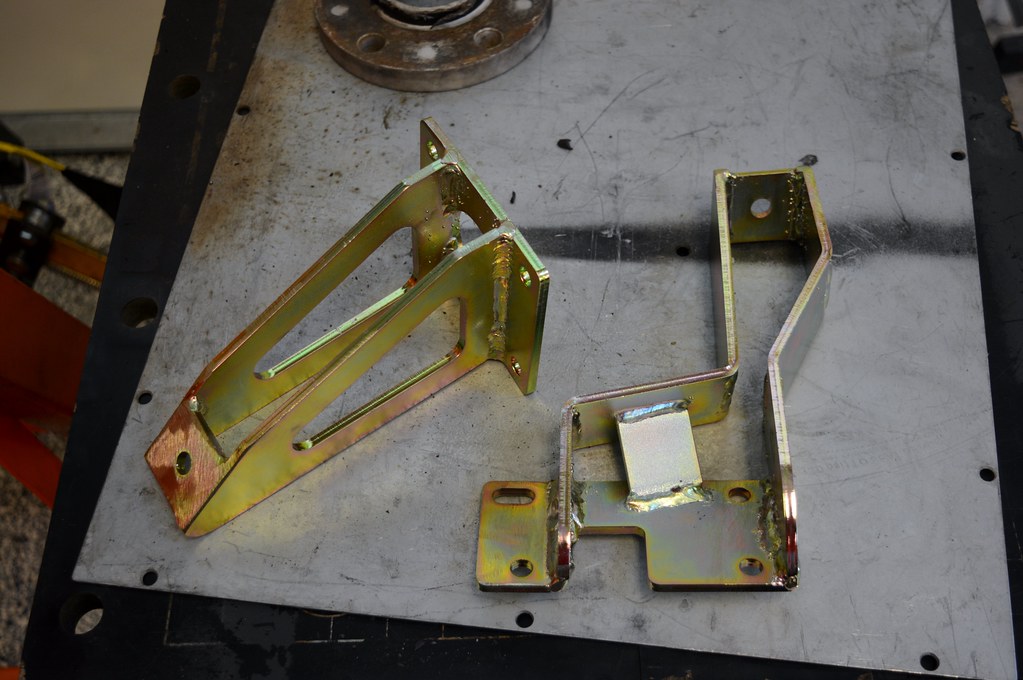

Here are the M50/M52 mounts I purchased. Nobody seems to know if these will work on an S54 or not, but I can always sell them...
