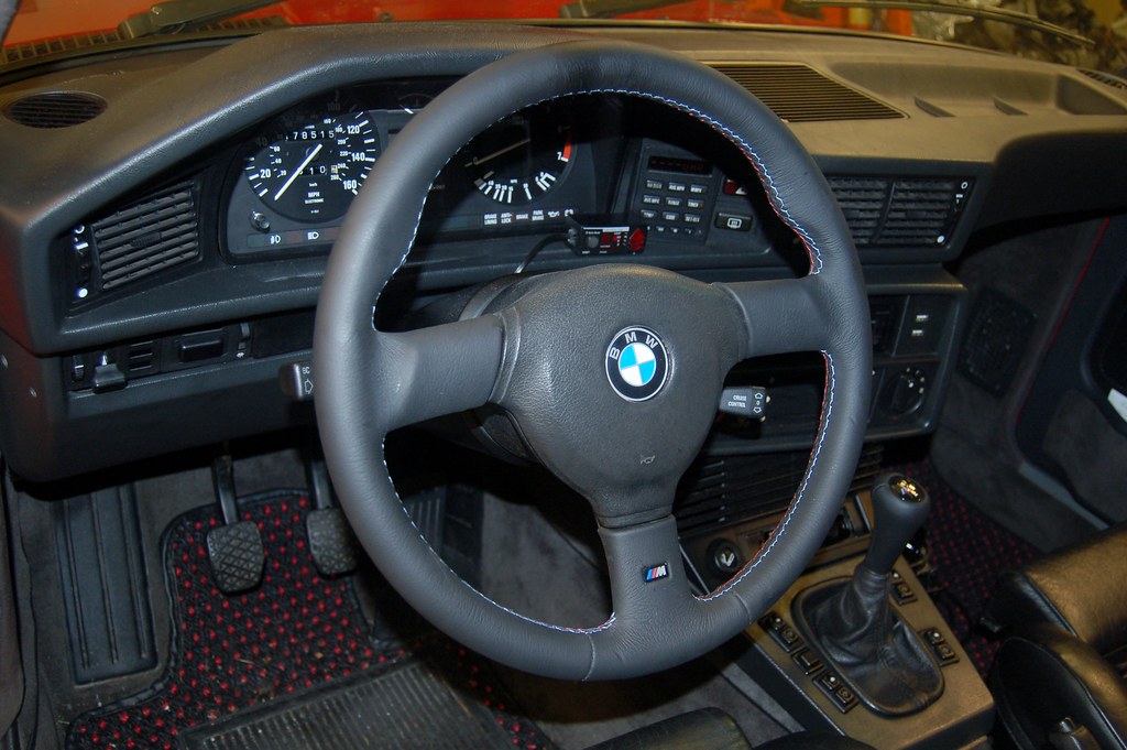

Not only did Vlad just get a new engine, clutch, flywheel, and short shift kit, he also got a new steering wheel.
