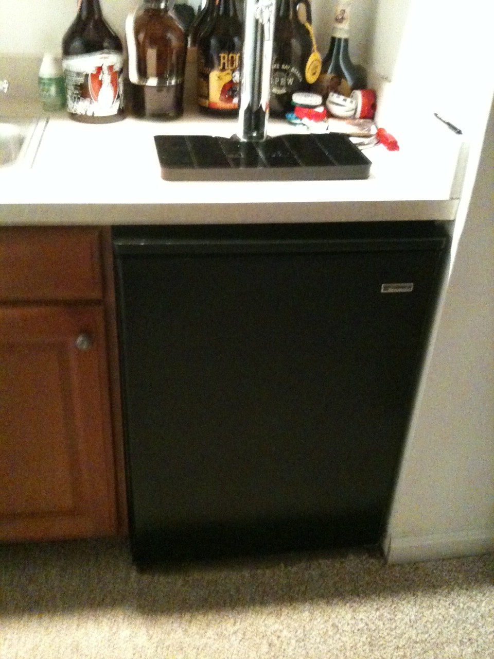

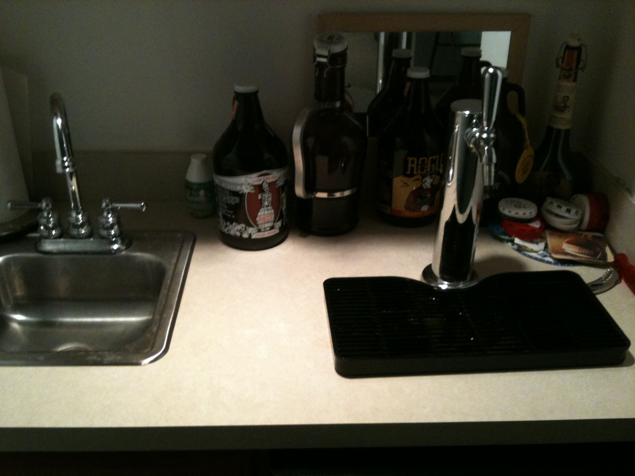

I used a regular Kenmore beer cooler to do something similar in my basement (sorry for the cell phone pics). My next completely unncessary project is to run a line for the drain tray into the sink drain under the counter.

all good advice,
long runs require insulated lines and Alley Gas which is CO2 and Nitrous mixed,
costing you more money and harder to get in small amounts,,,
keep it simple like in the pics Graham posted...
