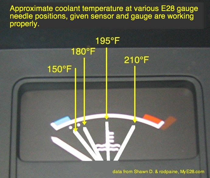

Does anyone know the specific temps for the various points on the coolant temp indicator e.g. min temp (blue), 12 o'clock, and beginning of the red zone? Also what is the normal operating temp range for the regular eta? What is too hot? I am giving up on the cluster coolant indicator as it is possessed by demons, so I added a mechanical temp gauge.

Here you go!!!
(courtesy of Shawn D. & Rod Paine)
