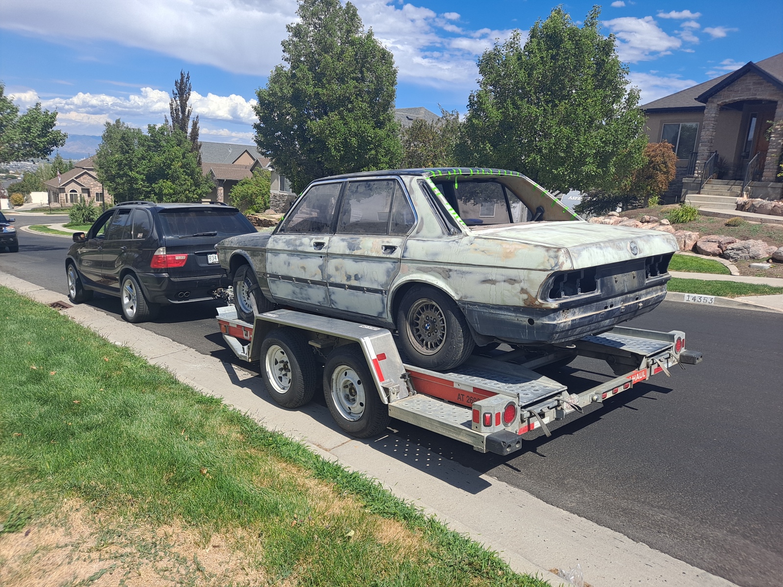

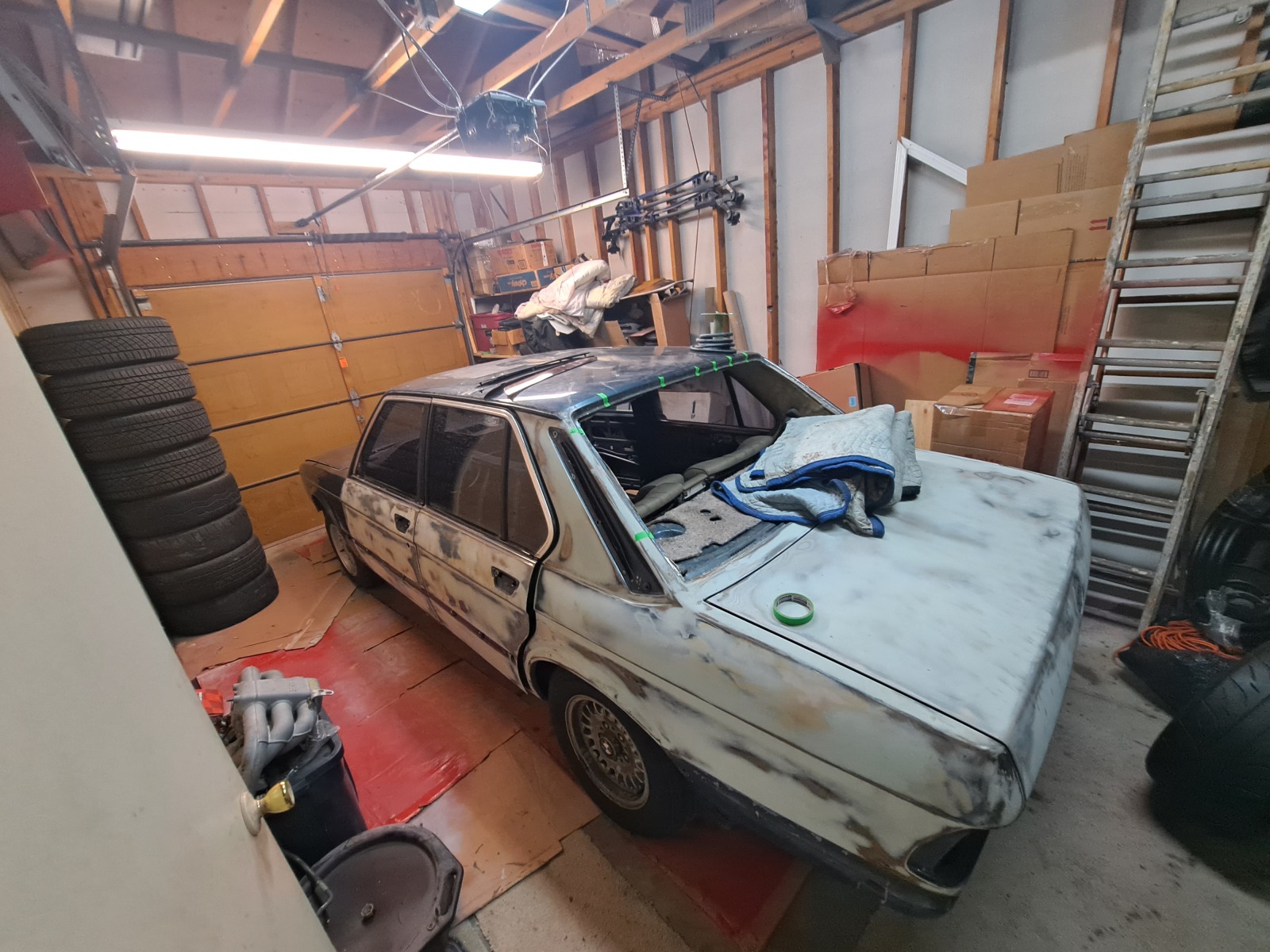

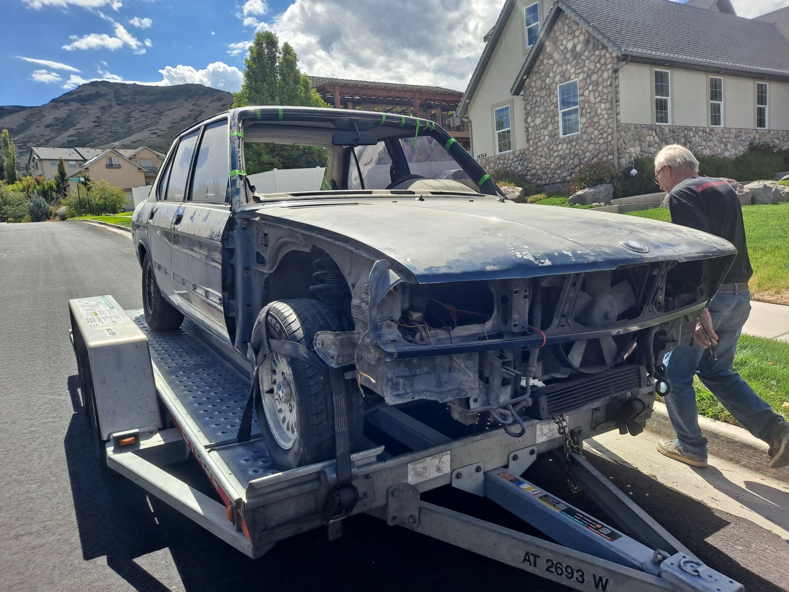

I also found another early euro 635 and bought it and have been working on getting it running and driving again. Off the road since possibly 1988 :shock:
Little progress getting a bunch of things replaced and running. I will need to decide what to do with it. It is a 1979 slicktop, henna red, M90, dogleg, lesd and recaro car...

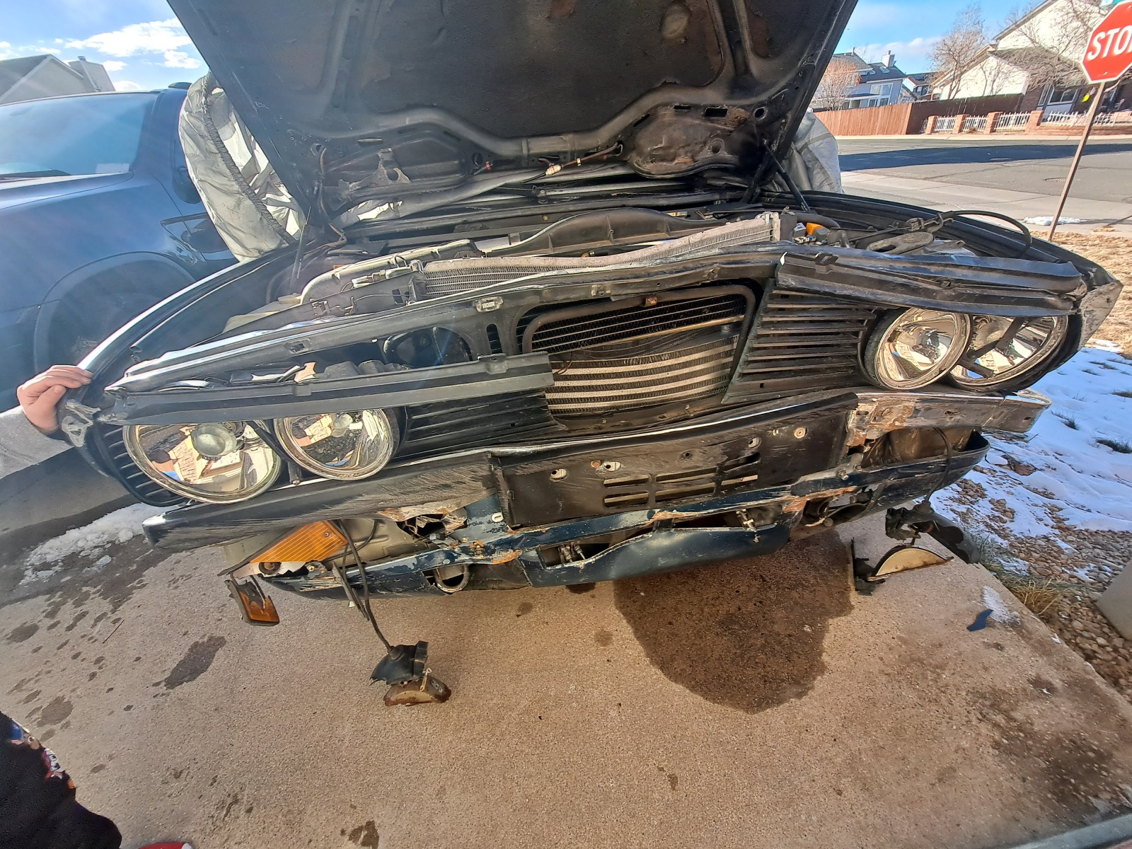

The euro look is pretty exciting for me, even if the paint is sort of rough. Here I was pulling the nose out to power wash off grease and grime while I was in here. It was pretty oily due to the blowby of the engine with oil in a lot of areas and some dirt stuck everywhere. I haven't really driven the car much with this setup with the new piping and euro bumpers, so it is still a bit new to me to be admiring. The wipers are replicas but complete the look :cool:
The biggest mess was by the hydroboost areas and steering box. Looking better...

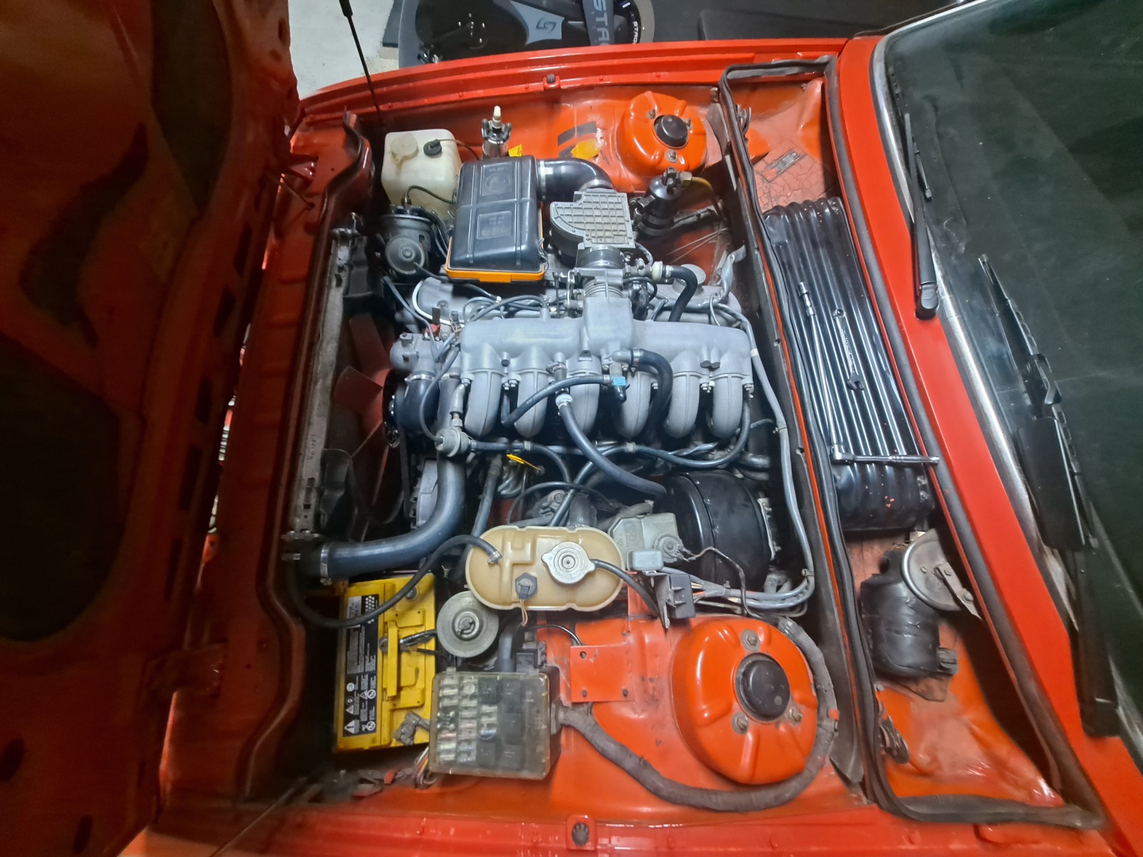

Here is the new engine build with 42# bosch injectors, B35 pistons, head and intake. New rings and bearings. I am keeping the B34 style oil filter housing, fuel rail and valve cover for the correct E28 look. I also kept the B32/B34 intake manifold support bracket
Engine going in recently.
I wanted to mount the intercooler piping better and found this Ireland Engineering adapter to allow me to gain some clearance and remote mount the FPR. I think it is a pretty decent solution. I didn't want to try an adjustable FPR if I didn't have to. One less variable and I can keep things stock...
I found that I had two different water pump pullies, so I went with the larger one to flow a little bit better. Can't recall when there were differences via models, maybe S38 vs M30 but I read about it here on mye28. I also added a new blow off valve and hope this one works a bit better than the recirculating one I had.
Downpipe, trans/flywheel/ clutch and all is back in place, I just need to finish putting the exhaust back on. Here is the engine and turbo setup with all piping in place. It sort of looks like a crazy mess of wires and hoses. Not sure it is 'pretty' but it should work ok.

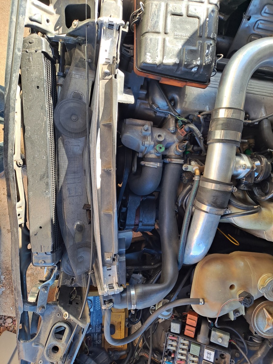

Speaking of intake temps, I have wondered if the standard intake is causing problems like heat soak. But when driving along, it seems like temps are 10-15F above ambient, which seems very reasonable to me as the sensor is in a pipe just above the valve cover and cylinder head! Moving faster benefits the A/A intercooler, and obviously slower could make it worse if stuck in traffic with no airflow.
Here's my intercooler placement. Good airflow through the front grilles and a little blockage by the bumpers, but that's about it. The standard valance and license plate mount and spoiler has a nice opening area to allow airflow through. That is the bottom edge, and you can see it with the minor crunch on the lower edge of the intercooler
Good news, the nissan radiator was holding temp of 180-190 F, only creeping up if idling in place without the fan and viscous fan cutch installed.

I haven't posted here because of frustration over the car. Last year I swapped on some old All season tires and at the end of the year, got in a wreck on a highway ramp I have drive 100's of times now.
Some combination of colder temps, narrow/older tires, small moisture and the B35/turbo power allowed me to get squirrely coming out of the curve of the highway ramp. The car started sliding and I couldn't correct it and crashed. I didn't want to slide off the road sideways or something to the inside and ended up front first into the wall. I have been super frustrated about all of it since it happened.
I smashed my rust free car, smashed my euro front end setup and ruined the car that was running and looking amazing just as I was ready to consider plans to repaint it. Also my intercooler, euro valance, Alpina spoiler and and other hard to find parts were gone in addition to some sort of damage to the transmission mounts near the tunnel and the cross member for the G265.
More frustrating was seeing the damage to the frame rail and a small crease near the A pillar and the front door no longer aligning.
Needless to say, it has been a sore subject for me.
I was able to tear apart the front end, put in a spare radiator, cut and bend some metal just enough to fit it together and start up the engine. The engine has a rubbing sliding noise, so I think a timing guide may be broken and the engine is probably off timing  because idle vacuum isn't near as low as it was before, though idle was perfectly smooth otherwise. I suspect it is a best case scenario. But I got it to start up and idle nicely and could move the car off my driveway while I determined next steps.

I got the engine back together and a rebuilt brake booster in with new brake lines, and a new master cylinder. Oh yeah, also retrofitted an e28 radiator to make it all work with an e28 water pump and fan clutch

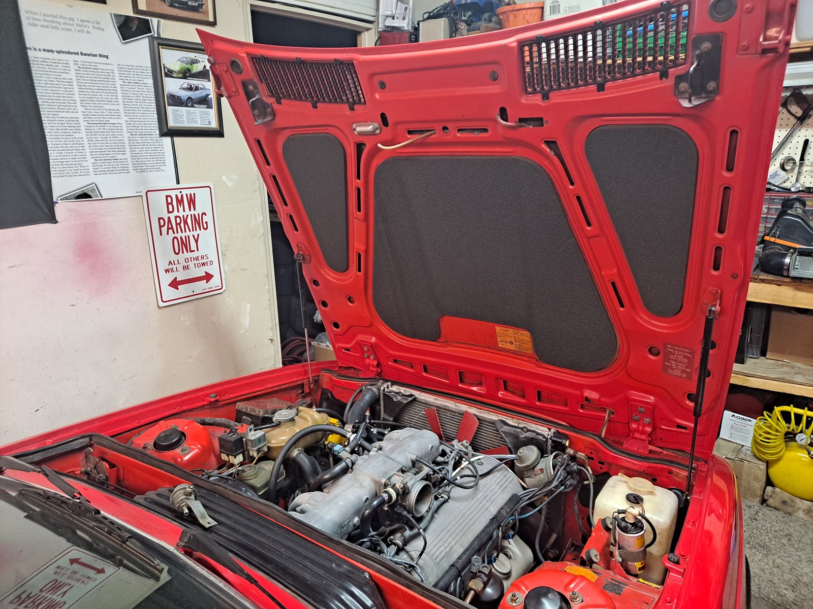

Installed the foam for the engine bay and am currently fiddling with adjustable FPR and AFM tuning without an O2 sensor
Back to the subject at hand, I was casually looking at E28's and other options for my e28. I liked the setup with turbo so much on the 535is and decided i'd like to rebuild it. But I am not sure rebuilding is possible, so I was looking for the right replacement. I decided to buy TonkaTruck's M535i which was Darin in STL's old car.
I picked it up last weekend and will be transplanting parts to continue the turbo E28 project.
Lots of work ahead, but I have started organizing parts and getting going on next steps which will be body work and paint before some decision on engine work... I may look at the B35 turbo engine setup, or i may look at building my spare b35 block and head, I am not sure just yet...

I am still kicking myself as I look at the bodywork required on this shell. The hood had a few dents and dings and creases and the frame nose panel has been pushed in a bit. I will attempt to pull it out by about 1 inch.
But onward, I guess. It is rewarding to make progress and see the progression at least.
