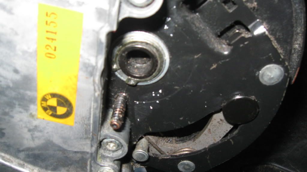

To separate the motors from the sport seat, you'll see there's these pins that slide through pivot points that are integral to the seat. Pop them out. It's actually pretty simple, but I've got a lot of experience. Sport seats are an entirely different animal than comforts. Be prepared to cut your headrest motor wiring, unless you have terminal connector tools.
Basically, here's what you need:
-Philips screw driver (two screws to secure seatback to hinges).
-Circlip pliers to remove the circlip that holds the hinges/gearboxes to the seat bottom)
-once the circlip is removed, simply move the cam and it will allow the hinge to be rotated and removed from the axle.
-Hogring pliers to remove all of the hogrings holding the center cushion to the springs
-Flat screwdriver to pry up the fingers that hold the side bolster upholstery to the frame and you'll also need this to remove the clip which holds the knee bolster to the linkage. This also helps to depress the spring that holds the pins in place.

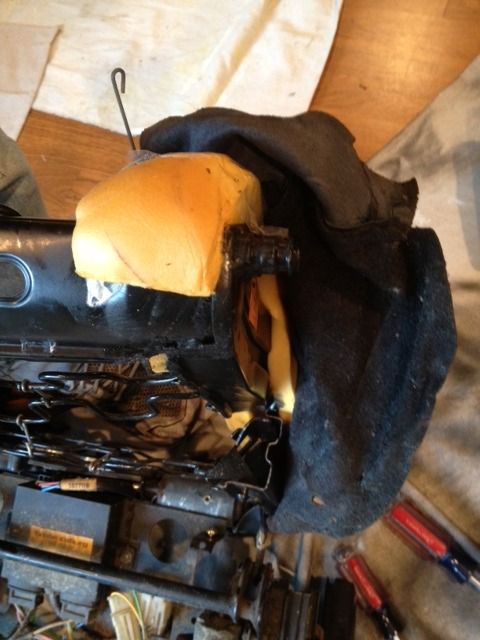

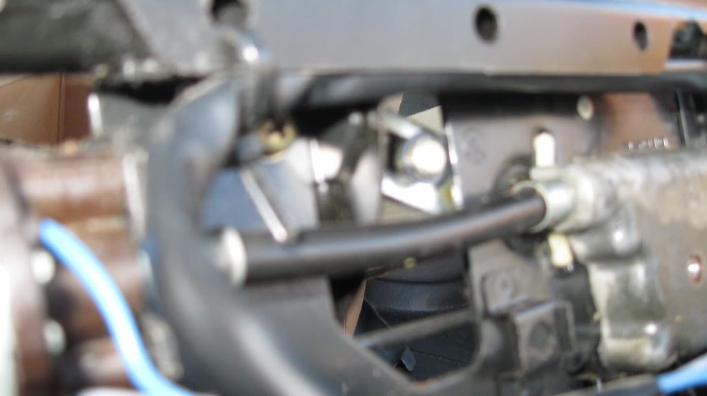

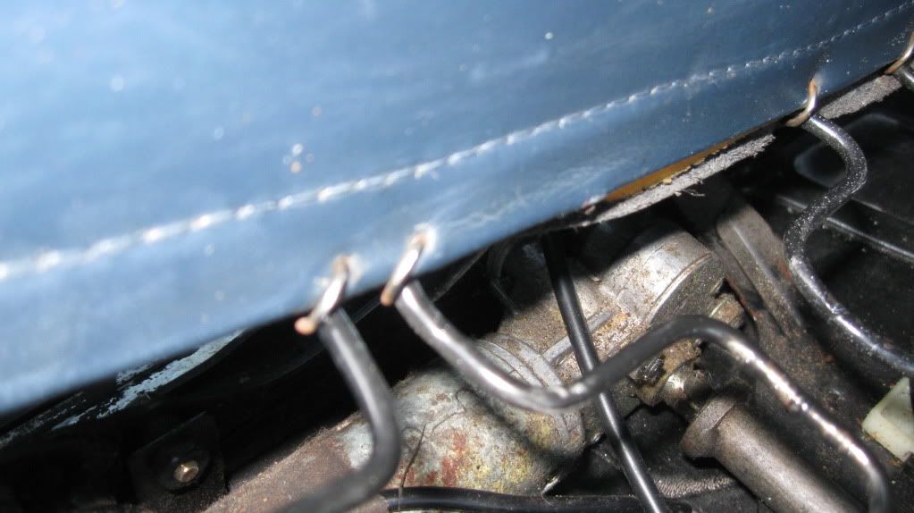

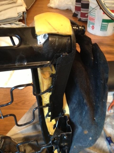

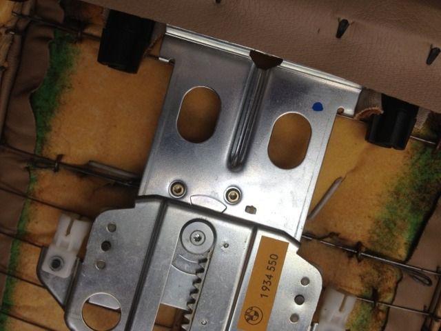

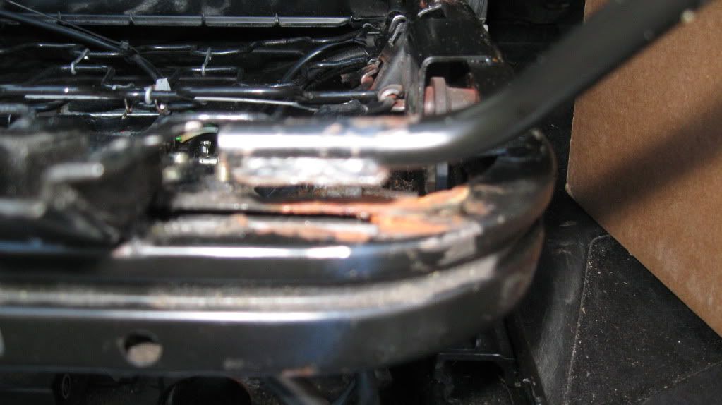

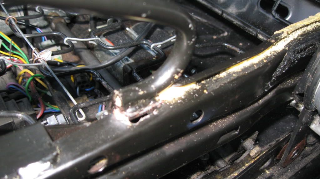

Pics for Chris' description:
Broken bolster frame rear
Broken bolster frame forward
Rings and springs
Hinge circlip and cam
ering at thigh bolster (from below)
Plug in the welder and get out the rings & pliers[/img]

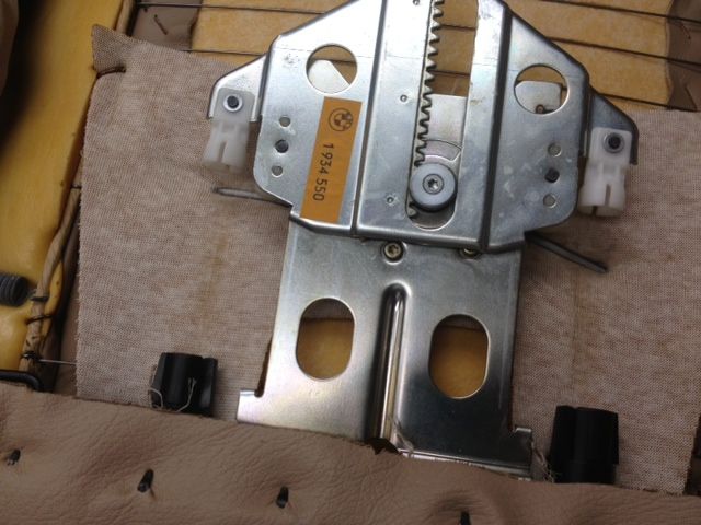

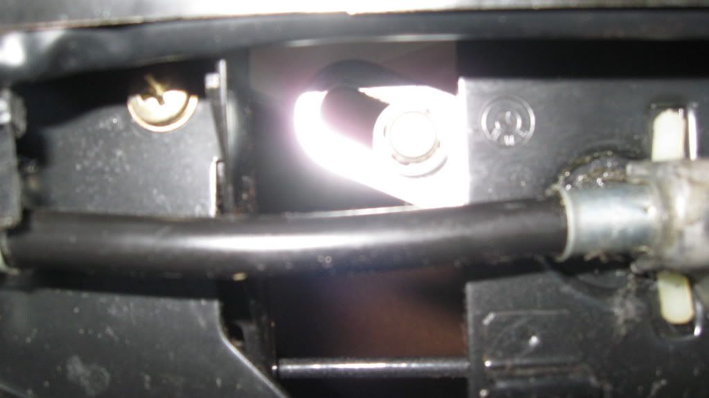

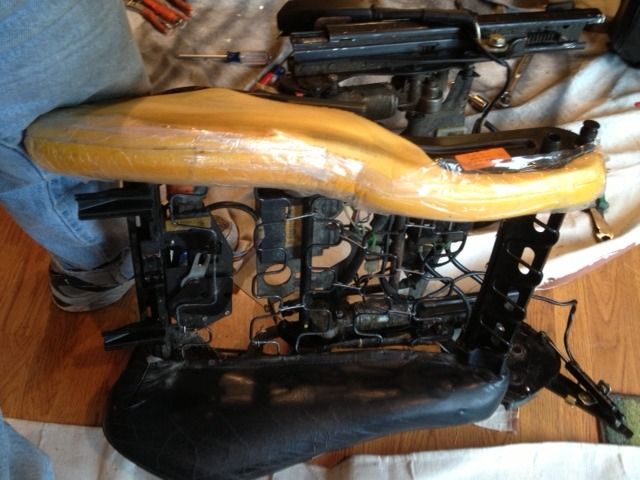

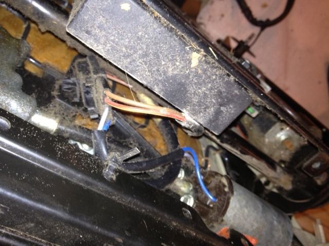

More pics:
Wiring to front thigh bolster from the power harness:

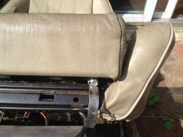

broken seat frame similar to Leonard's:

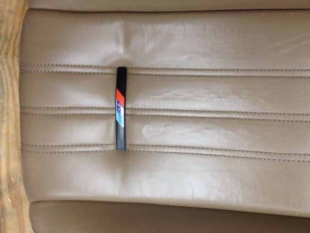

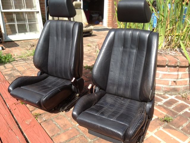

///M badges - original installation. I can't account for why the pins were bent differently, but one bowed out and wore more severely than the other.
I'm repairing/refinishing three sets of sport seats now. :shock: My M5 seat frames aren't broken, but it looks like a bolster repair had been made in the past. They're getting Leatherique Rejeuvenator/Prestine and color touch up. Each of the other sets had broken driver's bottom frames or bolsters and will also get the Leatherique treatment. Time to get out the welder! :rockon:
