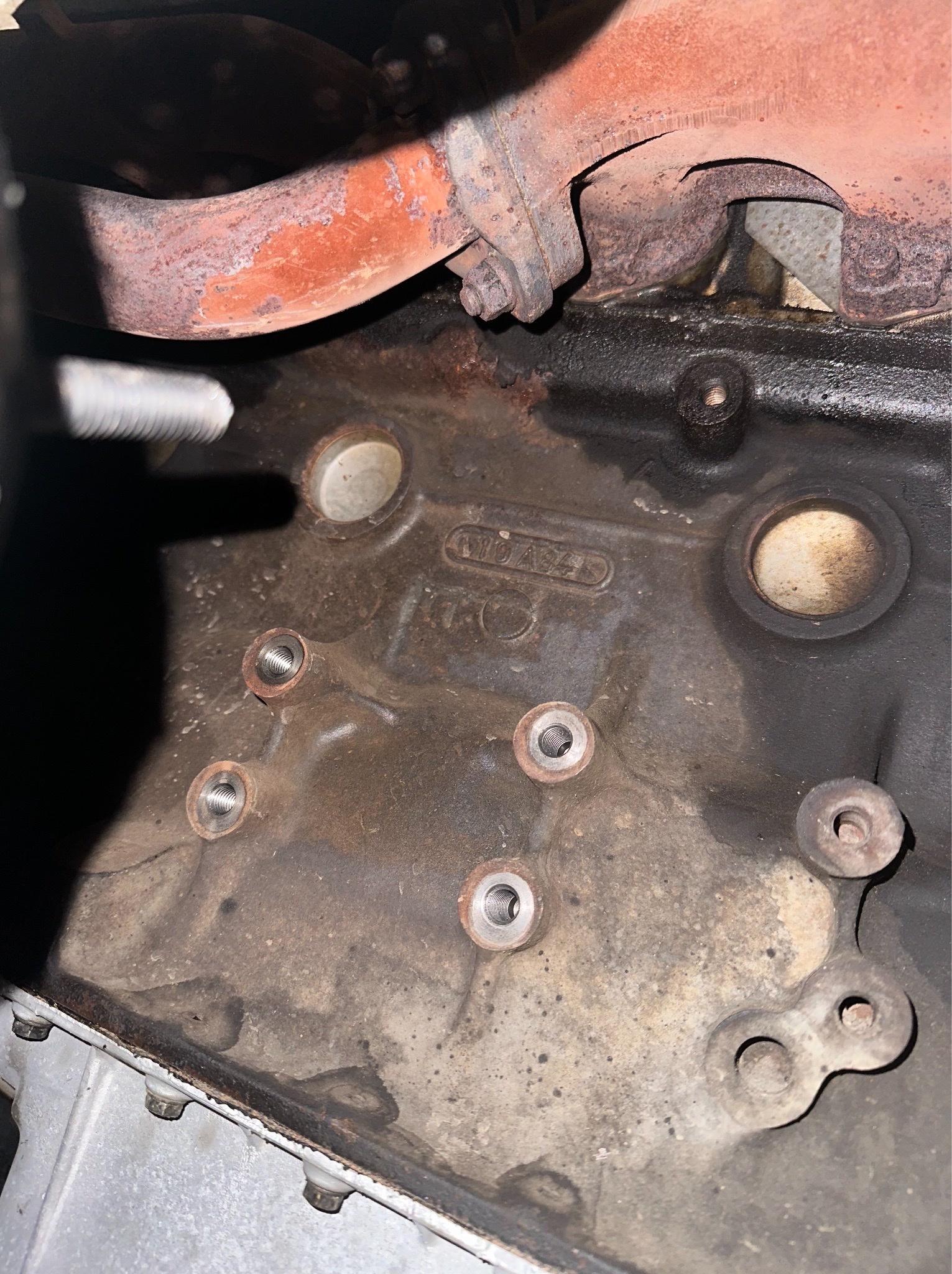

Managed to get into the shop today and take a picture of the mounting location it seems to me that the top bolt hole is there for the later bracket. Please do correct me if I’m wrong. Thank you all for your help!

Re: Right supporting arm
It's been a few, but that's what I remember it should look like. You might want to chase the threads with a tap before bolting it up. Might just thread right in, but looks a little rusty.
