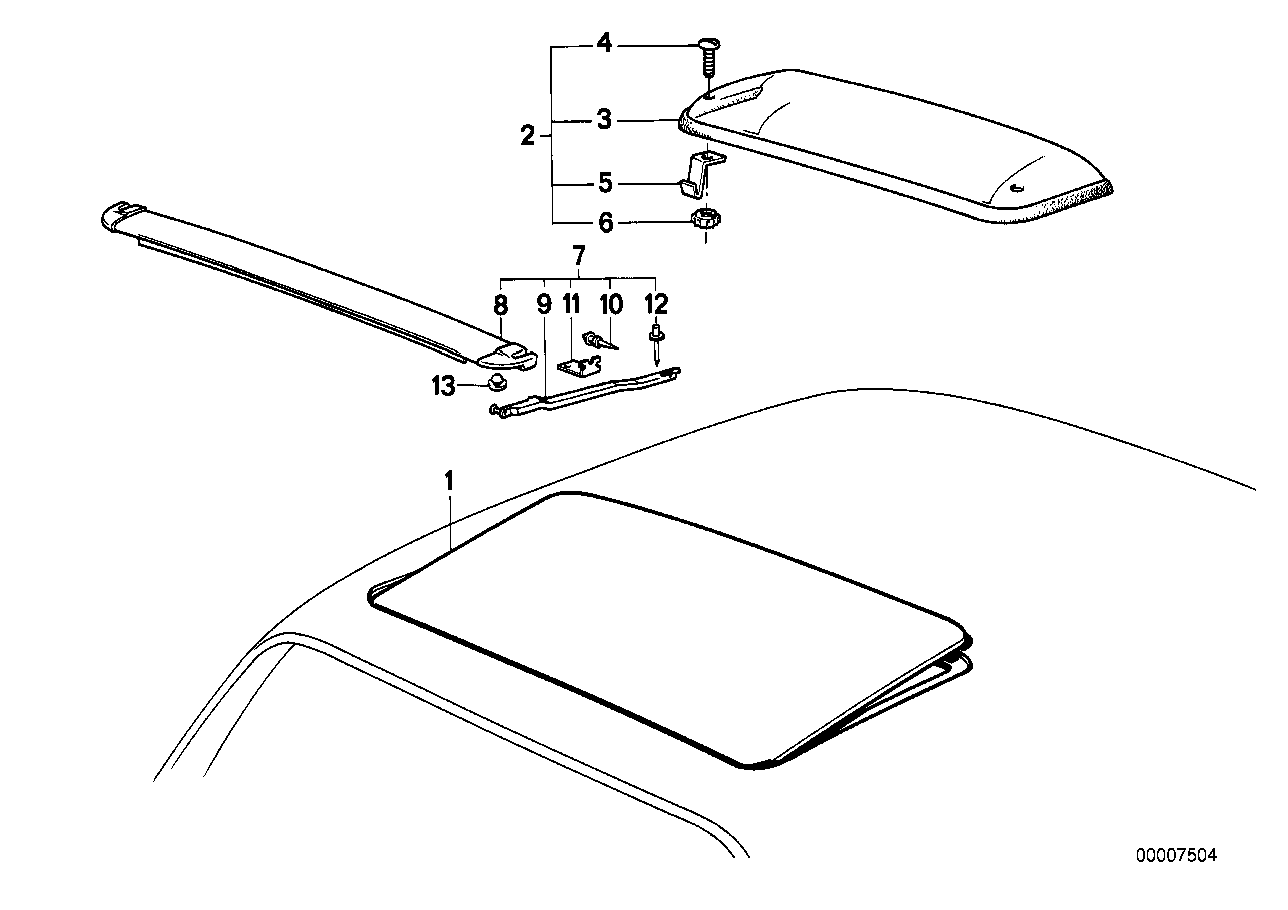

I’m converting my sunroof from Panel to moonroof.
Can someone tell me how to remove the arms that are on the body that tilt the wind deflector?

I want to think it's a little circlip, but Realoem shows a rivet. Regardless, I do recall clearly that the little bracket that the arm attaches to is welded to the roof/sunroof tray.

The slipstream deflector rear arms sit into small brackets which are welded to the sun roof trough. The rivets(item 12) act as the pivot pin for the arms.
https://www.realoem.com/bmw/images/diag_5sg.png
Remove both rivets (pivot pins) to release both rear arms. The front of the slipstream deflector removes as per the JBort guide.
The small brackets remain and do not interfere with the glass moon roof.
